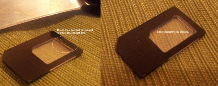

Re: Sim card reader ruined on my Moto G - can it be repaired?
Many people broke their sim slot pins that way. It's not an easy job to remove and solder a new simslot to the phone unless you have the right tool. You can find some type of repair service that may be able to do it for you.
Or you can call up Motorola and send it in for a repair for a fee.
When you remove the sim adapter, you need to use something to lift the card from the bottom and softly jiggle the adapter left and right while removing it, both of this help for the edges of the adapter not getting caught to the sim slot's contact pins.
asfasdfadfadfadf
