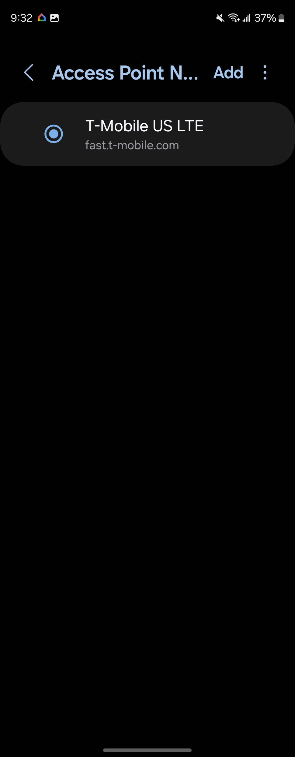

Check if your APN is highlighted to do so go to settings>connection>mobile Data>APN tap

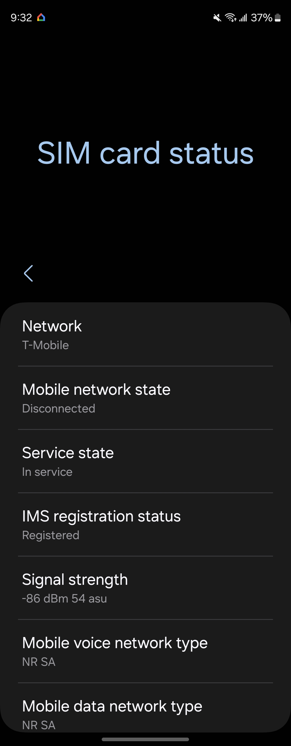

Next go to settings>about phone>status information>sim card status>service State is it in service look at my screen shot for reference
