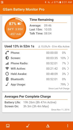

Okay, second day in a row where my battery level dropped like a rock. 15 to 17% per hour!!!!! I also noticed that during this time my battery level on my ASUS Zenwatch 2 was dropping pretty fast. I usually can go 3-4 days on my watch between charges, but yesterday the problem with the phone caused my watch to use about 45% battery life.

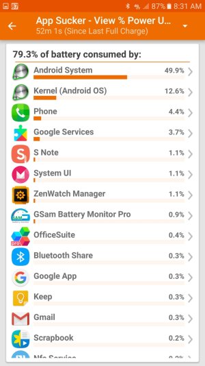

Yesterday I thought that it might have been Android Auto, so today on the way to work I did not use Android Auto on the way into work today, but the battery level was in free fall. I thought maybe it was a Bluetooth issue (connect both watch and car with Bluetooth and it is always on for the watch). I turned off Bluetooth, but the battery level still plummeted. I opened up GSAM Battery Monitor and noticed that Android System was taking about 40% off my battery life (WAY TOO HIGH).

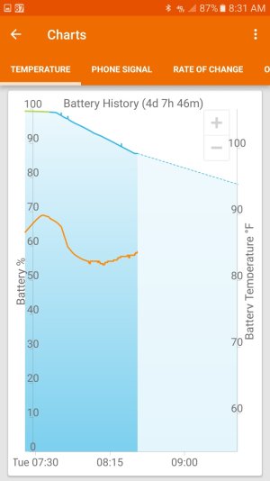

The only thing that I found so far to stop the plummeting battery level is to reboot the phone and then it goes back to normal. Here are some screenshots for your amusement.Screenshot_20161206-083132.jpgScreenshot_20161206-083137.jpgScreenshot_20161206-083144.jpg
Your cell signal looks really poor in that screenshot -- if that's how it is for most of the day, that can be a big cause of battery drain. It's helpful to see those same battery stats after you've used the phone normally from a full 100% charge down to a charge of about 20-30%, just so we have a good idea of what's been contributing to battery usage for almost an entire charge.

Ok -- but it would still be useful to see those battery stats over an entire battery charge (and not just down to 87%), so that we can get a better sense of what might be causing the drain.
