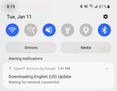

I have a 6 Pro from Verizon. Every time I restart I get the following notification. "Speech services by Google downloading English (US) update, waiting for network connection."
Of course I'm on the Verizon network and the download never starts. My first thought was that something was set to only download over wifi, so I went to Google settings and changed the Mobile data and Messaging setting to wifi and cellular under Data Management. No change. If I switch to wifi, the notification goes away, like it finished the download, but on restart the message comes back.
Anyone else getting this notification it have any ideas how to make it finish the download?

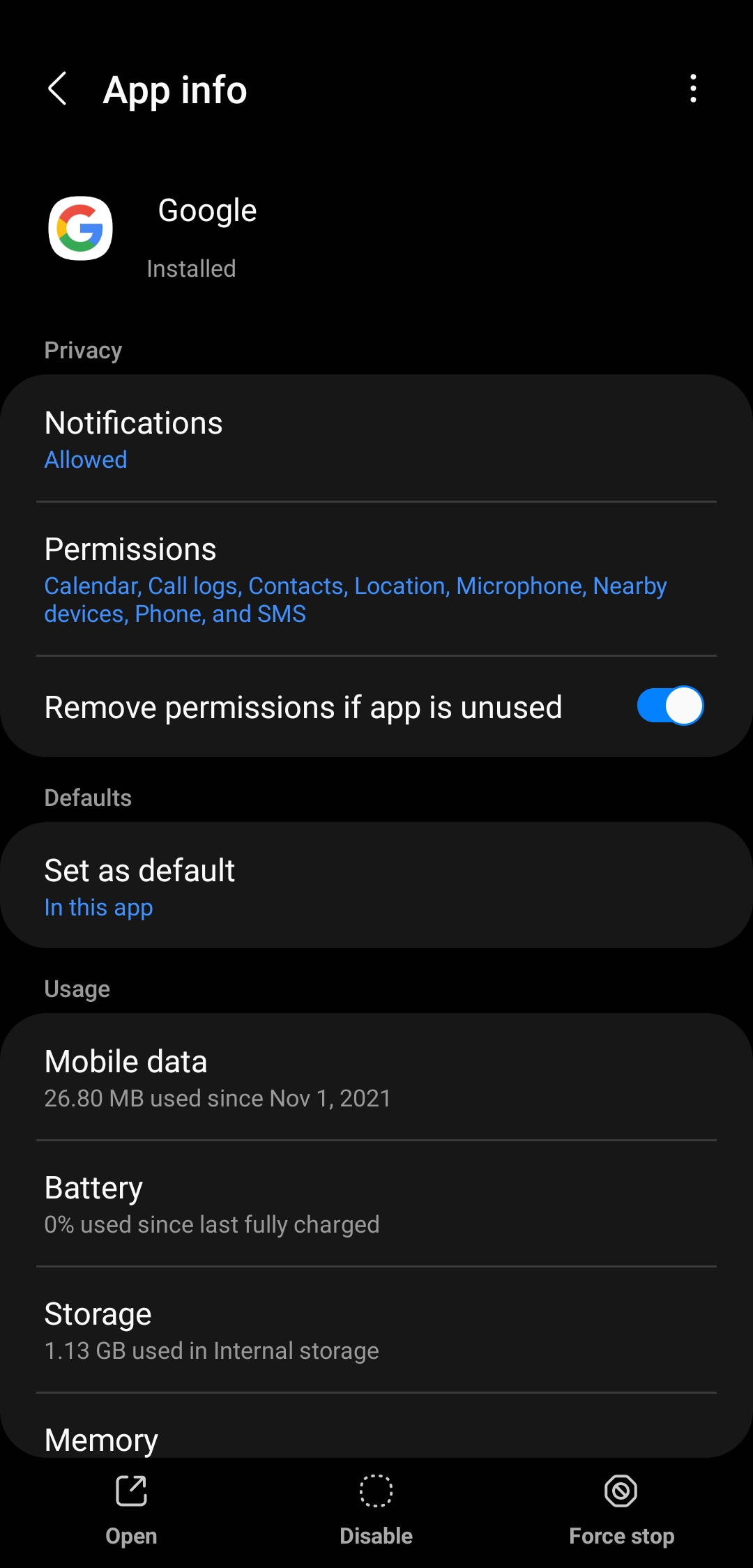

Try force stop the Google app , to donthat long press Google app then tap info , you should see force stop bottom right
