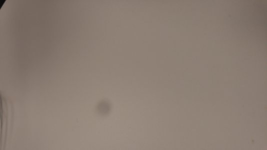

Yup that is what mine looks like.
Here is a pic of it..
