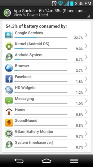

Google services is taking up 66% of my battery since I've unplugged it. Going down about 10% battery an hour.

Usually a simulated battery pull (hold the power button down until your phone restarts) will resolve this.

Thank you. This seemed to have worked. Weird that it happened though. Is this normal?
Re: Battery life is terrible
Normal? No. But it happens. Typically a memory leak or other problem with an app that causes it to go haywire. I've even had it happen with the Android Central App.
So, if I see a single app using huge amounts of battery or CPU, first thing I do is a simulated battery pull. If that doesn't fix it then I start looking elsewhere.

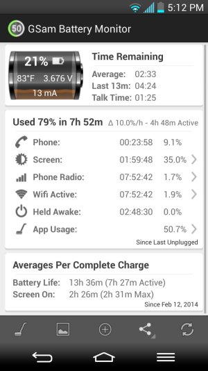

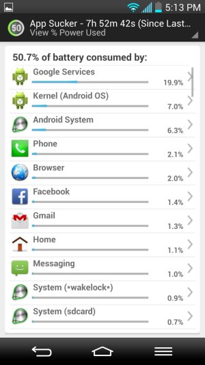

Here are some pictures of my battery stats. I have no idea why I'm getting such terrible battery life compared to what others are saying. I'd love to have some input or assistance on what could be going on.

View attachment 105534View attachment 105535
If you're rooted you can Greenify Google services. Otherwise, you'll need to manually stop it from running.
