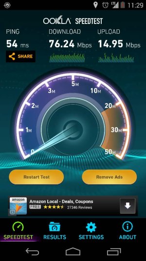

How can you tell what band you're on or frequency?
Sent from my SM-N900P using Tapatalk
On Sprint's LG G2 you can dial ##DEBUG# then click on "LTE Engineering" and it will list what band you are connected to.
