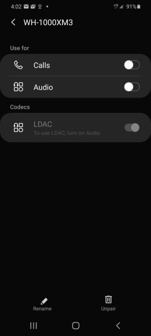

Settings>Connections>Bluetooth>WH-1000XM3>Toggle LDAC under codecs. (I think it's retarded that flagship audio gear running on flagship devices doesn't "default" to the best settings possible AND you have to jump through hoops in multiple and hidden menus to select the best settings!)

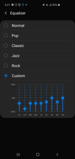

More icing on the cake, go into developer options and max out the LDAC settings except for bitrate, set that at 660kbps because it will skip at anything higher. I'll attach a screenshot of a good base EQ setting because the default house sound of the Sonys is very dull on top and with overly bloomy midbass. (Bassy music will still pound and have good sub bass, they will just sound a hell of a lot clearer on top and defined on the bottom)
Also in the Sony app make sure to select the sound quality setting to where it won't allow you to use the sony EQ. Use the phone's own EQ under settings>sound>etc.
