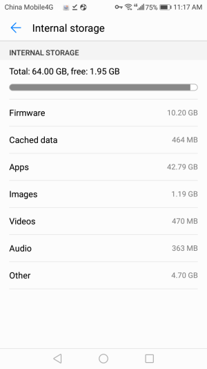

I have moved most of my photos and videos off my internal storage thinking that is where I was losing all kind of space.
I am still running out of room. Looking at m storage it says that I have 42.79 GB of apps, and that seems huge. I have about 70 total apps, and that includes what is built in. Weather, which is a few MB and such. Most of the apps are less than 100 MB.

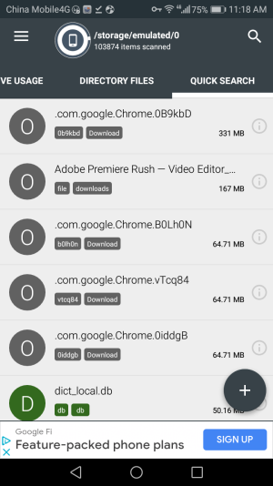

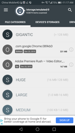

I used an app to check sizes and it says the larges files is Chrome, at 331 MB and the Premier Rush the nest largest at 167 MB.

It is giving me a "parse error" when trying to install it. Three different times, three different places. I can't use the GooglePLay store. Its a Chinese phone with a hardware block preventing that.
Did get a version to work, but its not helping. I tell it to scan the internal memory and it comes up with numbers that make no sense say for my Photos, because I have moved them to an internal card. And when I click on Show it tells me that they are on the external memory. Even though I tell the app to only scan the internal memory, not the external card.
Is there really not an app that I can plug my phone into my computer (I use a mac) and look at all the folder by file size? I use Android File transfer, and I can see folder, and I still do not see where this is all being used up and that app doesn't show file sizes.

Have you looked at your app storage numbers? This will be a bit tedious, but go into your app manager and look at the storage info for every individual app. An app by itself may not be very big, but the cache it generates could be large. For example, I have one online game that I've seen spike to 32GB of cache storage.
