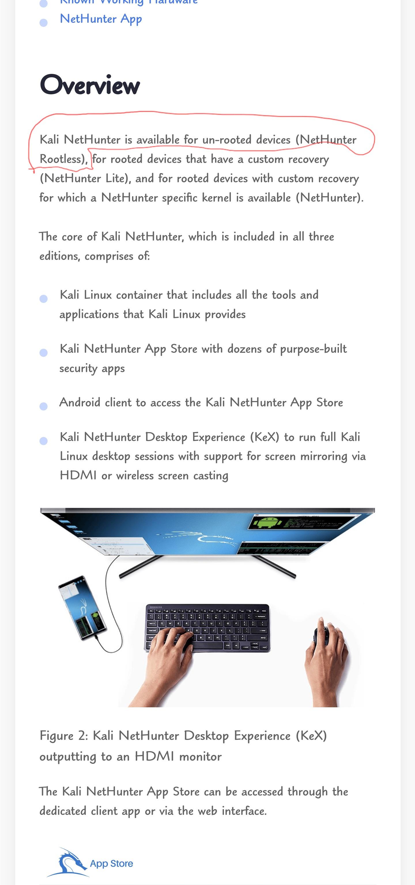

Im trying to install Nethunter on my Samsung Galaxy A10, the rooted installation requires me to push a package in the SDCard and then reboot the bootloader (from adb) for it to 'install', however the screen stays dead stuck on the "Downloading" screen.

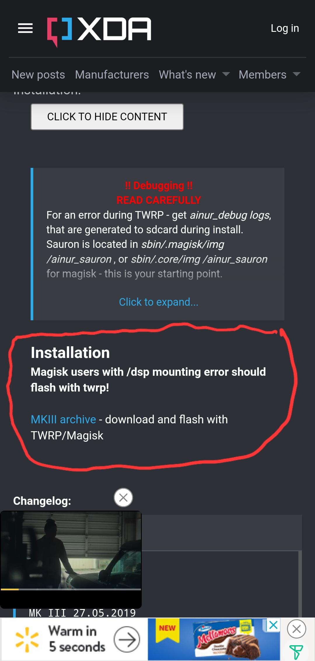

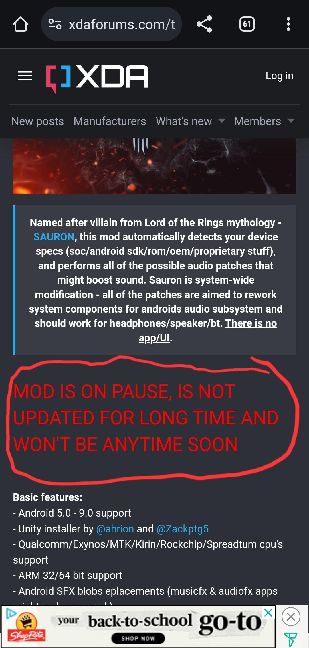

You will need to be rooted first and use either Magestic or TWRP recovery method , then you can side load the zip through recovery adb is in recovery but the zip is not going work with stock recovery as that zip updates a package that needs root and TWRP. I read the article you link which goes to XDA forums and that package is no longer supported or paused so if you run into issues there no fix .
You have to read before getting into something like this or your going run into trouble or break your phone .
