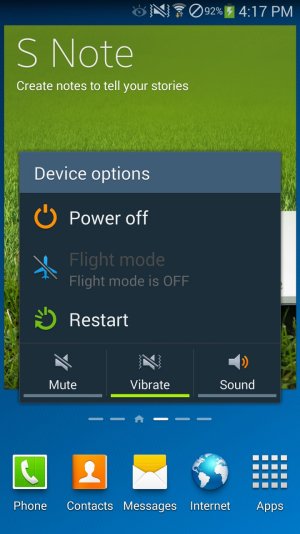

My unused ( and unrooted) note 3 SM-N900W8 is stuck in flight mode!
When I first turned it on I initially thought that the phone needed to be unlocked or was having sim card issues but I have ruled that out after troubleshooting; sim card changes, battery pulls, factory resets, firmware re-intallment, my IMEI and baseband are intact - 4.3 through kies). There is a 'no signal' icon on the top of the screen, and I can't connect or even access any mobile networks as it prompts me to insert a sim card.

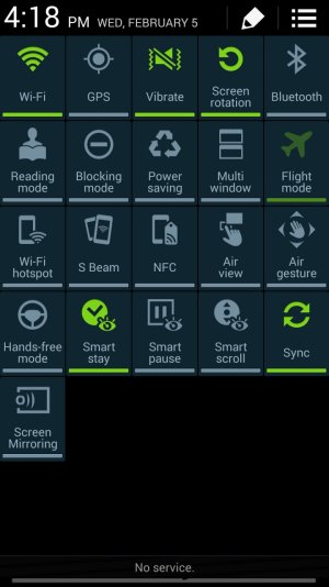

I then discovered discovered that my phone was on flight mode. Even when disabling flight mode from my settings (it appears off as there is no check mark beside "Flight mode"), when I go into my taskbar the flight mode icon is on (lit green) but it is greyed out.

An illustration of my flight mode issue below:
Pic 1: No Signal as indicated by the icon (between battery percentage and wifi icons)
Pic 2: Power button press shows flight mode is off
Pic 3 & 4: Notification panel tells a different story; flight mode is lit green indicating it is 'on' but it is greyed out - meaning I cannot toggle it

Pic 7: Yet in my settings, flight mode appears off

Turn on airplane mode and then restart the phone, when the phone comes back on then turn off airplane
your welcome ;)
