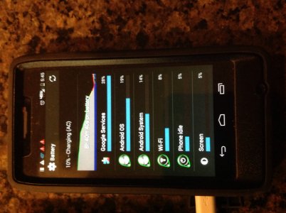

I've posted a Battery Screenshot. I noticed that the highest use is the Screen, but I have it set to the defaults: Auto brightness, 1 minute turn-off.

Which two apps are showing notifications in the screen shot? The one that looks like a coffee cup and the one next to it?
The "coffee cup" is a Leaf, I think, showing that the phone has gone into Battery Saver mode. This turns off the background data in order to conserve battery life. This functionality is built into the Maxx, it's not an add-on. To the right of that is the Simple Sound Widget, which I have been using for the last several years. It allows you to quickly select between Sound Profiles, like Normal, Night and Silent. It was last updated in 2013, so I can't blame it for anything (I think!)

Something else to look at. I noticed in your notifications that you have a temperature. I have noticed that weather apps that sync continually are a big battery drain. I would recommend if you can live without it to shut that down or at least change how often it synchronizes. There are apps that when you open them they sync to the correct temperature.

With Google services that high I wonder if you have a sync error. Look in settings / Google, tap your Gmail account and see if there are any red circles that keep spinning.

I doubt it is an issue with an app because none are high on your battery stats. Google Play Services should not be at the top of your list. Try clearing out Google play services and uninstall update in it as well. There could be a problem with your latest update of it.

I wanted to try without getting too elaborate, so I cleared the Google Play Cache to start with. I don't know what that did, but the battery life seems to be much improved. I'm getting through the day with a reasonable safety margin now, and that's all I really needed. Thanks for your help!
