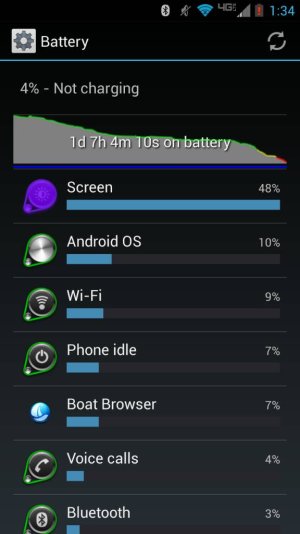

Suddenly Droid MAXX battery last less than 24 hours
On KitKat . . 17 hours on battery . . 7.5 hours screen on time . . battery 28% . . .
Sorry guys this is kind of funny even coming from a note 3 user
Sent from my SM-N900T using Tapatalk

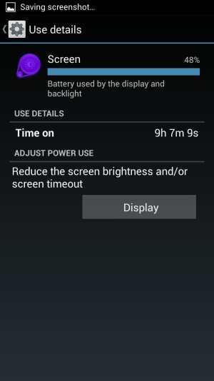

Something is def wrong. Screen should be first in the list of battery draw for sure.
Actually. Not true. It fluctuates between Android OS and Screen. The Android OS stats include the Kernel which includes all 8 cores of the X8 technology. Depending on actual screen usage, it will either be the first or second item on the list.
Valid. My Android OS and screen time fight for who can drain my phone more.
