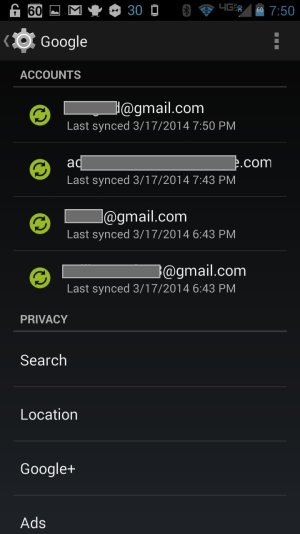

You can also go into settings->Google (under accounts), tap your google account, and turn off Google+ sync.

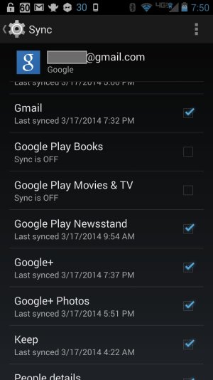

I'm not seeing an option to turn off Google+ sync, only stopping all of Google services from syncing. Am I missing something, or was that your suggestion?
Settings. Look for "google" under accounts and tap it. Under accounts at the top, tap the name of your Google account, which should have a green (or red) circle spin icon next to it. You will see a list of all of the items that can sync on that account; Google+ should be one of them.
Thanks for that, but what's weird is I don't have Google+ in my list, or Keep for that matter. My list goes from Newsstands to Ingress. To try and remedy the matter before I saw your post, I uninstalled all updates for it, leaving the factory app. So maybe that took it off the list. Either way it seems to have helped my battery since I did that. I won't know until I do a full recharge and see if I can get the 2 days and 1 night like I did before. Fingers crossed. :)

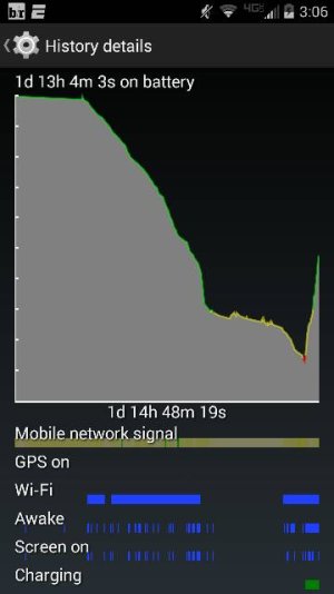

Ever since the 4.4.4 update for me.my battery life has been substantially reduced. Been trying everything I can think of to try and restore it back to where it was before the update. No luck so far.
Are these sharp declines normal for u all now?
From what I see in the picture you are getting over a day and a half and having 15-20% battery left. If I may ask what were you use to getting?
See that big area in the chart when wifi was off and the charge drop wasn't so great? Let me guess - you were sleeping?
If yes, plug in your phone then and you won't worry about running out of battery.
And, to answer your question - since the kitkat update last December/January , battery life has been worse than on jellybean before, yes. The 4.4.4 update helped a little, but not much. I probably drop an extra 1% to 2% an hour compared with before. Thankfully, there are almost always times that I plug in during the day - while I drive, while I sit at my desk, while I eat dinner ,etc. Even so, if I never get to plug in the phone, I still end the day with between 30 and 50 percent battery left, when I can plug in whole I am sleeping. That's good enough for me.
