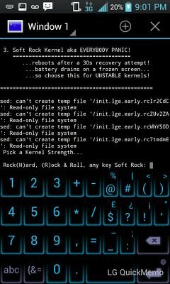

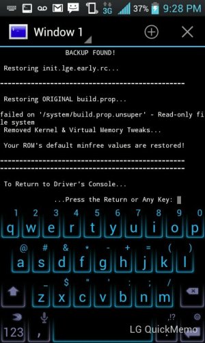

I'm getting these errors when trying to install I get sed: can't create temp file/init. Lge. Early. Rc.. I ill post pic and then I tried to un install it gett a can'tcreate file build prop un super read file only I've tried to mount as rw.still the same thing as help?
Like these? Same type of error here
