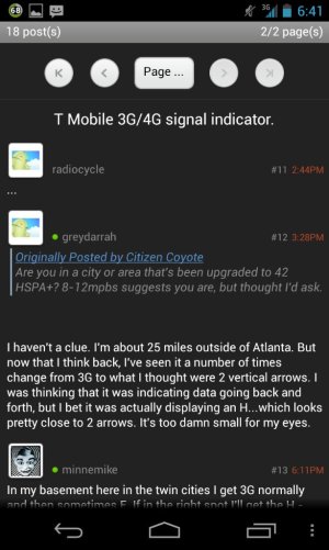

Here is what mine does as others have pointed out. When its using data its on H. On standby it shows 3g. This through T-Mobile
