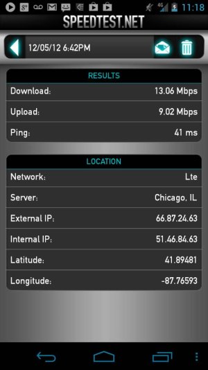

This is what I get on a BAD DAY LOL and FYI sprint lte isn't tryin to compete with att and vzw on speed but is more reliable

Reliable in what way? Right now Sprint LTE is not the pinnacle of reliability and it shouldn't be yet, they're still bringing the network up. Conditions are still spotty in a lot of the cities where there is actually an LTE deployment, some days there's LTE on one street corner and the next day it's not there at all. That's not to say it won't eventually be solid, but the LTE side of the network is quite scarce at the moment and reporting has been that it is fairly unstable in terms of when and where signal is received. (as per the chatter on S4GRU).
Sprint by way of the wide amount of spectrum they control through Clear might eventually be the fastest carrier, actually, but that is some time out. As it stands now, if you want to compare T-Mobile HSPA+42 with Sprint LTE under equal loading, they should perform about the same. 10 MHz SISO vs 5 MHz MIMO, both optimally 64 QAM.
Do u wanna know how many times I actually dropped lte since I bought this phone... Like Twice and that's because I was in part of the city yet complete I'm saying reliable as in when nv is complete because if the rest of the markets is gonna have lte speeds and coverage like here then is is gonna be reliable the only other lte carrier here that's matching sprint coverage is vzw and they are faster but drops 4g at a much stronger signal than sprint lte well at least my Gnex because I can hold a 105- 115 dBm in my basement
