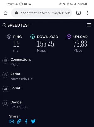

I just did this test on a Sprint Ultra 5G.
I've never had speeds go over 100.00 always been in the high or low 90s.
So I'm going to assume the higher the number the better the speed.
