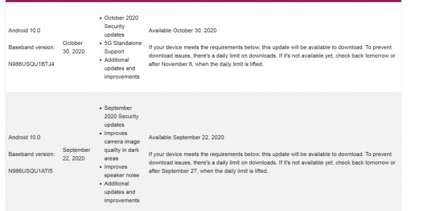

T-Mobile October/SA 5G update out today

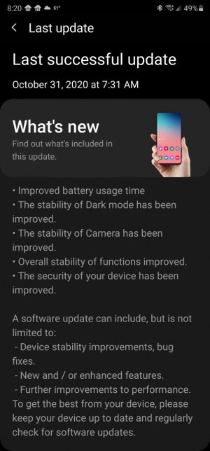

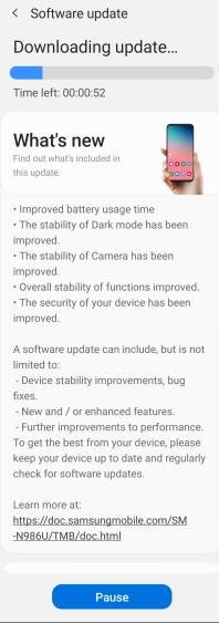

I checked my software upstairs and it was there. I went ahead and updated.
