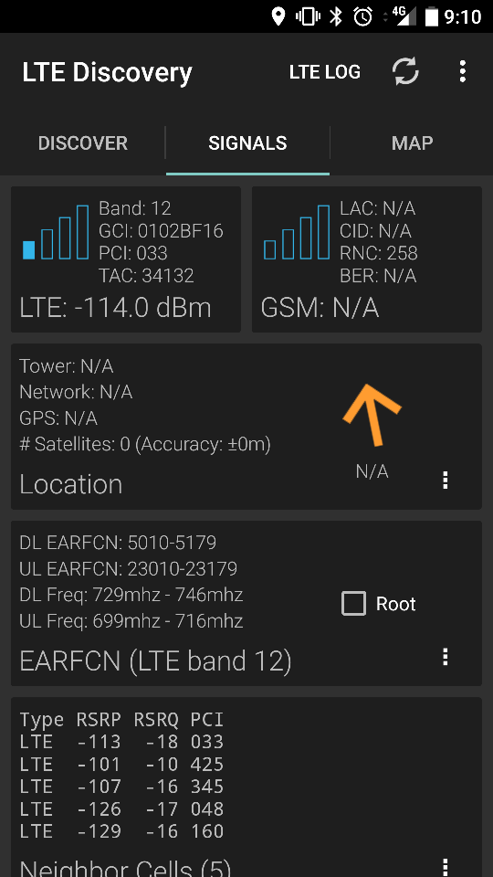

Alright, I am going to download that app after my phone restores from a factory reset (as per OnePlus support) and then post a screenshot. Then you guys can tell me if I am getting LTE or not because I have no idea what I am looking at LOL!
So does this mean I have LTE? I'm assuming so as VoLTE is working on my device.
