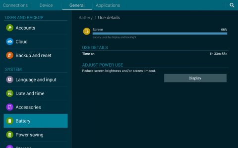

I read about the amazing battery life of this thing, however I am not able to hit 2 hours off a full charge, with power saving mode on, wifi and location settings off, screen on basic color scheme at 20%, background processes off. I'm using mobile Internet for browsing the Web (no videos) and chatting via viber/Facebook messenger. What's weirder is I often get large skips in battery drainage, as much as 20 percent, like from 61 to 40 is common, then in the 41-43 range down to 22, usually in the same spots. And it sometimes does the same thing when charging, I'll turn the screen on to check progress, and it'll say 83 percent, then just instantly jump to full. If I turn the device off and on, it turns back on with varying percentages, by as much as 40 percent, but within 10 minutes will rapidly dwindle itself back down to the previously lowest percentage. I've tried this over and over while charging to get it to take as much juice as possible and get it to use as much as possible while it's on but it doesn't seem to make a difference. I've tried factory restores and battery doctor and recalibration apps, this thing is like 2 weeks old. What gives? I've included a couple screen shots for the results of a 14h+ charge. Thanks in advance for everyone's help

Two things; One are you using a quick charger? Two have you tried bump charging?
I've personally experienced the down side to the quick charger, as well as read about its effect on other devices. Over time, and sometimes not even a long period of time, batteries charged quickly begin to drain quickly. After stopping my usage of the quick charger I found my battery life level out, however I don't feel I ever gained back that which I had lost.
Bump charging is simple and it gives you the fullest charge. On some devices the difference is night and day. To bump charge, charge the device until it reaches 100%, unplug it for 1 to 5 minutes, and then plug it back in until it reaches 100%. You can do all of this with the device powered on, however the results are even more improved if the second part is done while the device is off. I've begun doing this and seen an improvement, however I still don't think I've gained everything I've lost.
One additional thing is don't play with the device much or at all while charging. As you use power and attempt to charge the battery gets short cycled and over time this can degrade the battery resulting in quick discharging. Looking at your usage level it seems to be discharging gradually without many spikes or dips, it's just doing this over a short period of time.
No, I've only been using the stock Samsung charger it came with, and when I said I was trying to give it as much juice as possible, apparently bump charging was what I was doing, when I did that, I had fully charged the device with it off, and bump charged it while off also, for about 4 hours of bump charging until it would stay at 100 percent for at least a few minutes after unplugging, and also sitting at 99 percent and charging for 20 or 30 minutes. Alas, no changes. And again, I doubt battery degradation is the issue, it's <3 weeks old. Thank you though
There was one dip I from 30 to 20 if you look, it does it less often (at least not the larger increments) on power save, but the big 10-20 percent sudden drops are there, I had screens hot but lost them in my last factory restore. But trust me, they still happen. Also, on a similar note, it's not charging extremely fast also, as if the battery is worn out, it still takes 4 to 5 hours, sometimes more to get to 100 percent. So I don't think I'm getting partial charges.

Yeah, I've calibrated when full, calibrated when empty, every charge is a full cycle charge, 100 to <10 (it takes 1h 30m) so naturally. I think I'm giving up on something I have done or can do to fix it, it's gotta be a bad unit. Unfortunately I'm US military and stationed in Italy, and my tab s is one I got while training in Lithuania, in which I will not return. My only mailing address is located in Italy, but because it is us military it's a us address and is only accessible by USPS, I thing Samsung uses fedex or DHL, so it becomes quite the headache to get warranty service figured out, usually places won't even do it for me because of my address, and of they do, it takes months. But I'm not seeing I have a choice.
