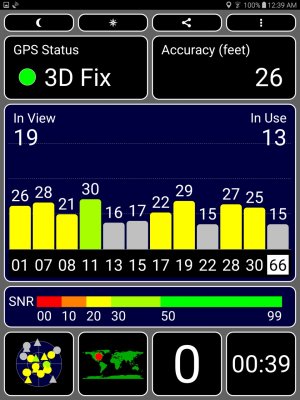

Any app that displays the satellite numbers will work. The two I use are called GPS Test and GPS Status. Here's a screen shot from GPS test. The satellite numbers are along the bottom with the signal strength displayed above in a bar.

Unlike those are WAAS sats. If the number corresponds to PRN, then 30 was a GPS sat while 66 was a GLONASS sat. WAAS numbers are always over 120.
