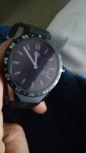

1. I received my Connected from Tokyo 2 weeks ago. Wore the watch for just 6 days before i noticed that there were are bubbles between the glass and the LCD display. Please see attached picture. It cannot be water as I've not exposed it to any wster. I was extremely disappointed as I've been wanting to get the watch since it's launch in Nov 15.
2. I brought the watch immediately to the Tag Heuer customer service centre in Singapore where I stay.
3. They told me that they will have to consult the main office in Switzerland as the watch is not launched in Singapore yet. To date I've no idea how long I'll have to wait to get it back.
4. Wonder if anyone out there have encountered this defect also.
5. Extremely disappointed 😞

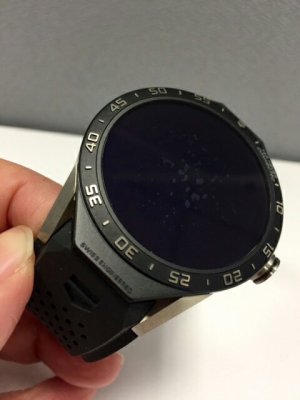

I have same problem with Air Bubbles Insede Screen. I handed the watch to a local service TAG for warranty and I'm still waiting for a report from the workshop.

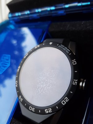

I picked my new watch up last week and within a day its done exactly the same. Good job it has a 2 year warranty! Love the watch but not impressed with the screen 'bubbles'IMG_20160510_115323.jpg

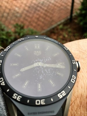

I had exactly the same problem, returned the watch to Tag. Excellent customer service and received a replacement watch within 3 weeks. However, I have been wearing the new watch for about 10 days now and am starting to see 'bubbles' again! I think it is acid from fingers reacting to the coating on the screen (just a guess based on no science whatsoever!). This is a real shame because I love the watch.

Had the same issue...bubbles that started small and spread over time. TAG replaced it after a delay they blamed on a "stocking issue". Sounds like demand is high. Wonder if it's an overheating issue causing the coating to degrade...they did warn me about leaving it plugged into anything other than a wall outlet. I avoided laptop / car charging out of fear!
The serial number of the replacement begins with PE, while the first one with the issue started with GL. Curious about other folks. Hope nothing happens with this one because waiting on the replacement was torture!

If I had to guess at the reason for this failure, it's the presence of dust particles during assembly. I bet they didn't assemble the touch screen in a clean room and they should have. All it took was some repeated finger pressure to make voids appear.

The bubbles are coming from the Anti Reflective coating that Tag uses. I have had the same thing happen to another mechanical tag I own. It will contoniue to come back. I have asked Tag to simply polish off the coating and not put it back on my mechanical watch and I'm about to do the same for the connected.
