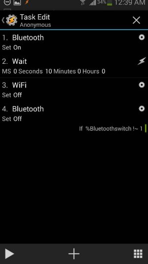

Need some advice.
I'm trying to set it up to where if I disconnect from Wifi, my blue tooth turns on. I have that set as an exit task.
I now want to add an additional setting to that exit task and work so if it does not connect to blue tooth within 2 minutes of disconnecting from Wifi, it turns blue tooth off.
Any suggestions?

I have a answer but it's a little long and I am out to eat I will give the step by step when I get a chance.
Ok got it and tested it. Seems to be working good! So to do this you will need to use variables. I don't know if you have used them yet but basicly they are, well variables, being that they change depending on the state of the phone. There are a bunch built in to tasker but as far as I know there isn't one that detects if bluetooth is actually connected or not. So I had to build my own. So this is how it goes..
1. Make a profile state/net/bluetooth connection(not bluetooth status). In the menu leave all the fields as they are so it will work for any bluetooth connection.
2. Make a new task, name it like bluetooth switch on or something.
3. In the task hit the plus sign to add one, then go to variable/variable add
4. In variable add at the top where it say name, type %Bluetoothswitch make sure you have one upper case and the % sign in front. Then set it to add 1.
5. Go out and add an exit task to the profile you just created, name it like bluetooth switch off. In this one go to variable/variable subtract. This time at the name slot if you tap the dog tag like things at the top you should be able to find your bluetoothswitch in the list. Then make sure the subtraction is set at 1.
6. Now how I did the wifi thing is I made a state/Net/wifi connected, then at the bottom of the wifi connection I checked the box invert. That just makes it do the opposite, so when you disconnect from wifi it will activate. Then make a task and give it a name.
7. In the task go to net/bluetooth. In the settings have it set bluetooth to on. Click the back button.
8. Hit the add button again to add another task, go to Tasker/Wait. In the menu set it to 2 mins. Click the back button again.
9. Add a third task, this time go back to Net/bluetooth. In the menu set it to bluetooth off. Then go to the bottom and check the box if. When you check the if box a new line will appear. Click the dog tags and find your %Bluetoothswitch. Then click the box with the symbol on it and select "Matches". Then in the last line put a 1.
10. Back to the profile menu and find the profile you just made with the wifi discconect. Hold down on the actual name of the profile, not the state or task. If you did what I did it should say "not wifi connected". Hold until the options appear at the top of the screen. Tap the preferences tab. In preferences, uncheck the box that says restore settings.
You should be good now. After you disconnect Wifi it will activate the 2nd profile we just made. It will then turn on bluetooth. If Something connects to the bluetooth it will turn on the switch and then it will not shut the bluetooth off. If nothing connects it will turn the bluetooth off after 2 mins.
One note! If you don't seem to have the same options as me make sure your Tasker isn't in beginner mode!
Hope it goes well! Let me know if you have any problems. It might not be the cleanest but it is the only way I can think of right now.

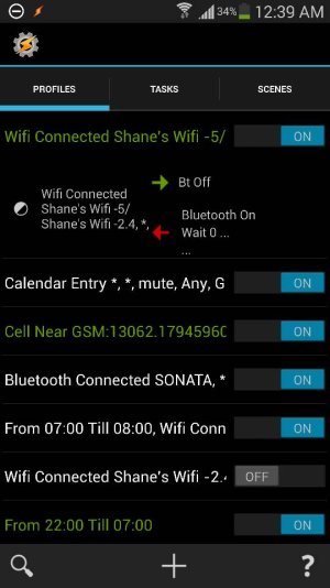

Thanks! Variables were exactly what I was thinking. Did it slightly different but same premise. Have it set for 10 seconds in these pictures but I'll play with the timing later.
I'm in and out of my house often for sales so this should work great. Thanks for the help!
