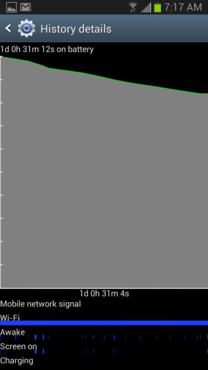

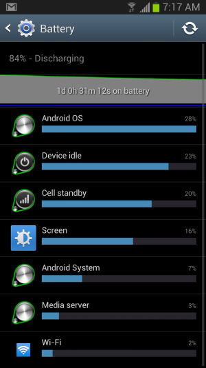

I did the following changes:
1. On the advice received on this thread and other similar ones, I've disabled all AT&T apps except for AT&T Messages (need it for visual voicemail).
2. I've disabled notifications on ALL apps in the App Manager.
3. I've disabled "Allow automatic updating" on all apps in the PLAY Store.
4. I've disabled Samsung Push Service.
5. I've disabled sync for all accounts except for my work email (Exchange). That account is set to use push 9a-5p on M-F. Otherwise its at manual. I had to enable sync on Gmail app because Gmail wasn't working as expected (without sync on, messages deleted in the app wouldn't be deleted in Gmail).
6. Screen is set to 20% brightness.
7. GPS, Multi-Window, Bluetooth are all off.
8. Wi-Fi is off when I'm not in a Wi-Fi area. For me, that's 2 hours a day.
9. Turned off all vibration settings that I could find. Two that still exist are the Facebook messages (when I have the app open and I get a message) and the calendar appointment reminder. I've not found the option to disable those individually (I don't want to turn on power saving mode to disable haptic feedback).
10. Ask for more tips on this forum :)
Now the charge went down from 100% to 84% in 24 hours. That's acceptable. At this rate, I should go a full work week without needing to charge. Although that would be too much to ask and pointless in having a smartphone.
Here are screenshots post changes.

Go into wifi settings advanced...wifi on during sleep is more than likely set to "always" change it to never. Thats what happened with the upgrade tto 4.1.2...they screwed with wifi. Watch your battery percentage soar like a eagle as before. Was confirmed!!

JDub and BeRich
LucidMike76 just did another daily note 2 on you tube. This one is dedicated to the Battery Pooper 4.1.2 upgrade. When I called Samsung to ask why the change in Batt performance, they said AT&T had done some "things" to wifi because people were complaining. LucidMike76 says its the wifi always on in advanced wifi settings. I do not remember what it was set at prior to the 4.1.2 upgrade.. but if my memory serves me right, someone on xda said the same thing. "It will make a huge difference" " Battery Performance will return t9 what it was on 4.1.1@♡♥"
I have changed the setting to never and turned off multi window per a tier3 tech suggestion at Samsung. He claimed his personal is a Note2 with ATT and the bloatware is also disabled which should be a plus to Batt performance. We shall see...

Changing the wifi advanced setting to never from always made a huge difference in battery usage. Does anyone remember how it was set under 4.1.2.? Also turning multiwindow off in notications. 25-30%!
that's some serious hypervolting. nice job.
