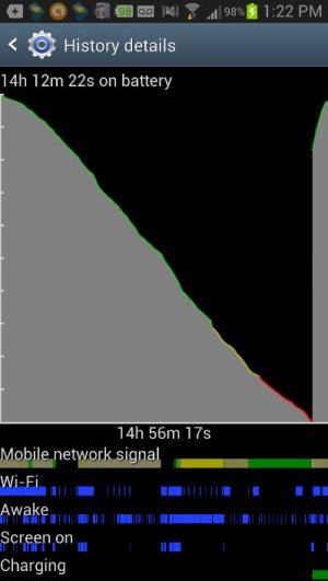

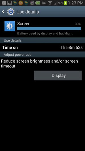

Ok, here are the screen shots.
The battery is draining very fast and that's with little usage during the day. The screen was not even on very much.
Here's an example.
Yesterday at around 2:00pm the battery was at 46%.
I put it into sleep mode and didn't use it at all afterwards.
I tried to turn it on at 10:00am this morning and the battery was dead.
That's crazy.
I am using the avast antivirus app on it but I don't think it's the issue.
Sorry, I'm not really sure how to interpret the colours.
Are the "blue" areas periods of activity?
Regarding the Mobile network signal, is the "gray" areas when it's poor, "green" when it's a good signal, and "yellow" when it's very poor and "black" when it's off or no signal?.

Your screen was on two hours and you are at over 14 hours usage. You are charging and at 98%. For the note 2, that isn't good. However, you can post screen shots without charging, and post the applications useage screen shot. Poor network signals will zap any device. I would kill your data in poor signal areas and that should get you back to 24 hour plus days.
