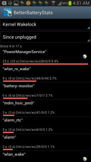

Ok everyone, I'm quite tired researching this issue but I have found the problem and solution.
It's because of the high number of wake locks that's preventing the phone from going into deep sleep when at rest. That's whats draining out the battery so fast.
I also uninstalled the app lock app that was causing a high number of wake locks also. It seems that there is a bug in the OS that's preventing the phone from going into deep sleep mode in-order to conserve battery power.
The fix: Put the phone into airplane mode, reboot the phone, once it's booted up take it off airplane mode.
The results: AMAZING!!!
I ran a couple of tests to prove it.
At 4:00pm two days ago the phone was at 91% 3 hours later (No usage in between) 85%. For me that was a BIG difference. Before this type of reboot I was getting an average drop of roughly 6% per hour.
By doing this I was able to cut that down to a 2% drop per hour. Very nice indeed. The wake lock situation also looks much better as the PowerManagerService was able to kick in now.
Also I was even able to improve on that.
After I had enabled power-saving mode, at 5:00am the battery was at 63%. 10 hours later at 3:00pm, (Again no usage in-between), usually by now it would be dead but it was at 49%. That's 1.4% battery drain per hour. Much better.
I guess if it starts to drain fast again I'll just have to do that procedure again but at least I was able to find a fix and share it with you all. (I don't take credit for it:))
Hopefully this gets fixed in the next update.

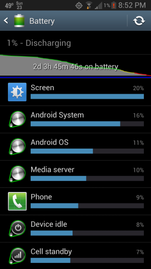

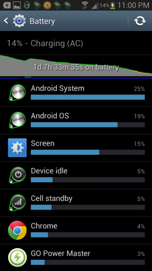

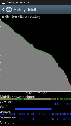

Here's some screen shots showing the improvement after the reboot. Before I was getting 14h 33m on a full charge. Now it's 1 day, 7hours. That over twice an improvement in battery life. Yeah! I'm loving this phone now!
Let me know if this fixes your power drain issues too.
Thanks everyone for all your replies and suggestions. The android community is a very good one indeed!

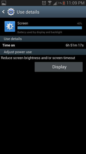

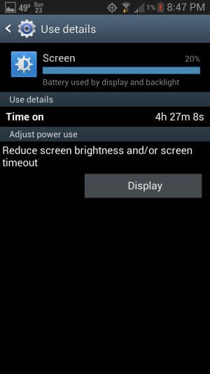

Here's my best battery life with heavy use. Tons of Facebooking, lots of Internet browsing and a couple hours of streaming video.
Almost 52 hours! To be fair this was with my screen turned all the way down when indoors and I only turned on bluetooth/gps when I actually used it.

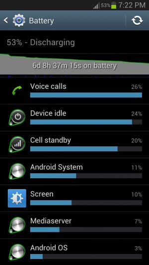

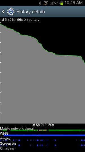

Mine has been great.
This was my first run-down..it has only gotten better too.
Sent from my SAMSUNG-SGH-I317 using Android Central Forums

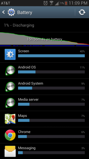

Mine has been awesome.
No doubt the battery life is awesome. Look at this on my 3rd day. I still trying to figure out why Google MAPS is pulling battery because I haven't used it. :/

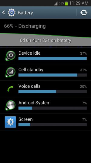

Hi all,
After an initial bad battery life, (because I had used it straight out of the box without charging, and let it discharge quite low into the red, thought that my battery was doomed). After allowing it to discharge till dead, and charging for more than 12 hours continuously over a period of a week I was able to improve on battery life, I got the best battery life on stock jelly bean, 6th day and 66%!. Now I don't discharge it to more than 40% to 50%, and I always disconnect the charger after a short while, of full charge. This charge cycle gives the best and most battery life.
While watching HD mkv 1080 format videos, battery discharges at the rate of 1% for every 10 minutes (and this is outdoors), and listening to music, I have everything tweaked in the equalizer including reverb and the works, drain is not noticeable. MX video player drains the battery faster than stock.
