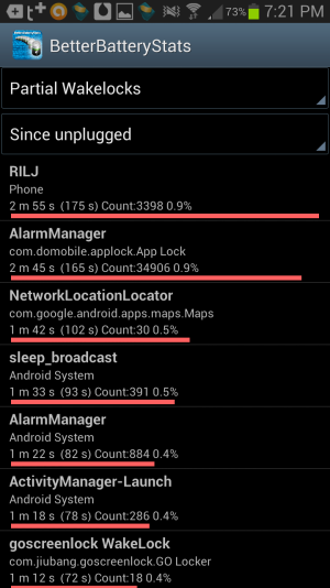

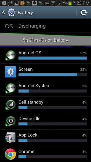

From a 100% charge at 2pm today, with practically no usage, at 7:18pm it's down to 73%. That's almost a 6% battery drain per hour. That can't be good.
By using better battery stats how can I tell if it's going into sleep or not.

OP you've got some serious wake lock issues. Seeing RIL as the top wakelock culprit I want you to try something, and I know this doesn't sound good but please try it. Tonight, if you can, put your phone into airplane mode but leave Wifi on and connected so you get data. If you wake up and experience minimal battery drain at best then I'm chalking it up to crappy signal quality and your phone having to wake up and push more power to the radio to keep you connected.

Gsam battery monitor is your friend. DL it. Understand it. Post screenies. Those yellow splotches under your battery. Not good. That means bad phone signal.
