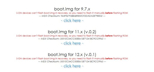

I have done all the steps correctly, I believe. I copied the fastboot app and "Shift + Right Click" and "Open Command Window Here" then flashed "boot.img" using this command "fastboot flash boot boot.img".
Afterwards I reached the final step here: "Find a ROM that's compatible with your device, download it and download gapps. When they're finished reboot into recovery, wipe cache, wipe dalvik cache, and do a factory reset. Then find the ROM you downloaded in probably your download folder. Tap it and hit flash. Once that's finished wipe cache and dalvik again." but I didn't flash gapps and I accidentally rebooted my device. Now it is stuck at the "HTC quietly brilliant" logo and nothing is happening. I tried rebooting by holding the power button and then the volume down button but it won't boot into recovery mode.. what do I do?????
I was finally able to boot it into recovery mode and I supposedly flashed gapps by copying fastboot into the Gapps file folder and executing this command " fastboot flash boot install-optional.sh"
Now whenever I use the power button to click "REBOOT" it keeps rebooting into recovery mode.. I am frustrated.

But am I flashing it the right way in the first place? I mean it takes like 0.5 seconds to flash the ROM when I run the command window and type "fastboot flash boot boot.img" is it supposed to be that short?
I feel like I am a moron. There's something missing and I don't know what it is. Have you taken a look at the screen shot I posted? There are only two folders and one boot.img file and nothing else. I actually had to download fastboot from HTCDev's website and copy it over there. What is missing?!?!

And by the way, I went into "Recovery" and then mounted the internal storage of the device on the computer. I then copied the ROM zip and the Gapps zip and I installed them after wiping the device and clearing cache and stuff, and then rebooted the device but it's still stuck at the logo. Is it now bricked?
YES!!! I HAVE FINALLY DONE IT. Omg.. I wouldn't have thought it would be so complicated. If only I had read several guides before attempting to do this, I would have been done in like 10 - 15 minutes maximum.
Anyway, I followed these steps exactly:
"turn OFF your phone
boot in bootloader
select fastboot mod
flash boot.img via fastboot that is located in the rom.zip: fastboot flash boot boot.img
run this command now: fastboot erase cache
go back to hboot screen
select recovery
full wipe is recommended if coming from sense, if coming from other AOSP roms than not
flash the rom
flash these gapps (Google applications - 20121011) -they NEED to be flashed after every ROM flash
boot'
I didn't understand what most of them meant until after a lot of trial and error and, of course, all your wonderful help which I cannot express how grateful I am for. I truly am sorry for wasting your time and bothering you, but I sure am glad I finally got through this as it truly was pissing me off.
