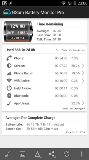

Why dont you try using an app like Tasker to control the background sync. I use it on a Turbo and get 40+ hours out of a battery. I set it up to shut background data down when my screen times out and reconnect when my screen wakes up. I use Gsam battery monitor to see which apps are running in the background. It has a screen in the program called app sucker that tells me which apps have used the battery and the percentage of such. Yes you may have to disable some apps to get stellar battery life.

Speaking only from expirence here. Its actually quite the opposite. I have noticed I can go 48+ hrs with the turbo. There are many factors that go into that but in my opinion apps running in the background eats the battery life and im not even using the phone. I just shut it down with the trigger of the screen timing out. Shuts down app sync and the 4g signal. Did the same thing for over 2 years with a Razr Maxx HD and never had a problem. Im not saying my settings are for everyone. I only offer it as a solution to apps running in the background and mystery battery drain. I would imagine the same can be done with the 6. I have both, Tasker and Gsam, running on a nexus 7 and 10 and both have 5.0 Lollipop. I really like Tasker because you can set it up to do almost anything. Heres a screen shot of my typical battery life. Screenshot_2014-11-13-23-00-13.jpg

Sure. I set up Tasker with a trigger of screen status. When it times out the actions are, disable background sync, shut off 4g, bluetooth off, and wifi off. The next trigger is the screen waking up. The actions are to re-enable background sync, and connect 4g signal.
I truely cant think of anything that I am losing by doing this. My opinion is this. It does not have a removable battery therefore there are only a certain number of charging cycles. I feel the need to maximize those cycles. It still allows calls and texts to come through. I usually check my phone every 15-20 minutes so if there's an email, facebook or twitter notification I grab it then. I don't like apps running in the background. Its my phone and I should have a say as to what happens in the background. Some might say they shouldn't have to do this and its too extreme. I think over time we expect more and more from these devices. Bigger, brighter screens are a big battery killer. Alot of people complain about battery life and I only offer these setting as a possible solution. Your mileage may vary!
