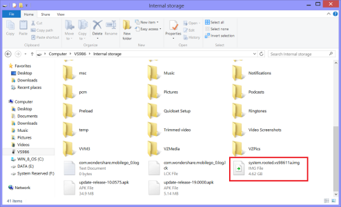

The tutorial says I need to save the 4.6 GB image file in the root of the internal SD card for this work correctly. I'm pretty sure i have the image in the correct location. Maybe one of you experts can verify that. See screenshot here:
Just before I started all this rooting business, the phone was nagging me about an "update" so of course I took the update *derp*. (bad move) Before: V98611A. Now it's at 13B
Do I need to find a new image? If that's the case, I'd much prefer to revert back to 11A if possible. I'm new to modding/rooting so I didn't think that the image I downloaded would be incompatible with my new phone post update status.
Really irked that I applied that update before rooting because now it seems i night need to find an image specifically for the 13B version. Any help would be appreciated. Thanks.

Go here on page 7. You need the rooted 13B image since you took the update. Taking the update to 13b wasn't a bad move, its the move you had to make. However if you were rooted on 11a you had to KDZ back to stock 11a before doing the update.
Just another note, there is no going back to 11a without an 11a system img that you had to make prior to updating to 13b. Just take your time and read through everything carefully. It sounds like you're moving in the right direction you just need that rooted 13b image and not the 11a from your picture.
