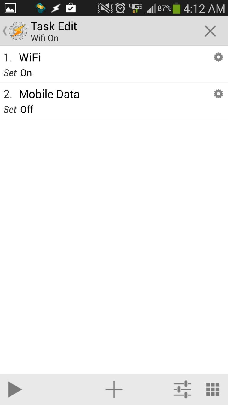

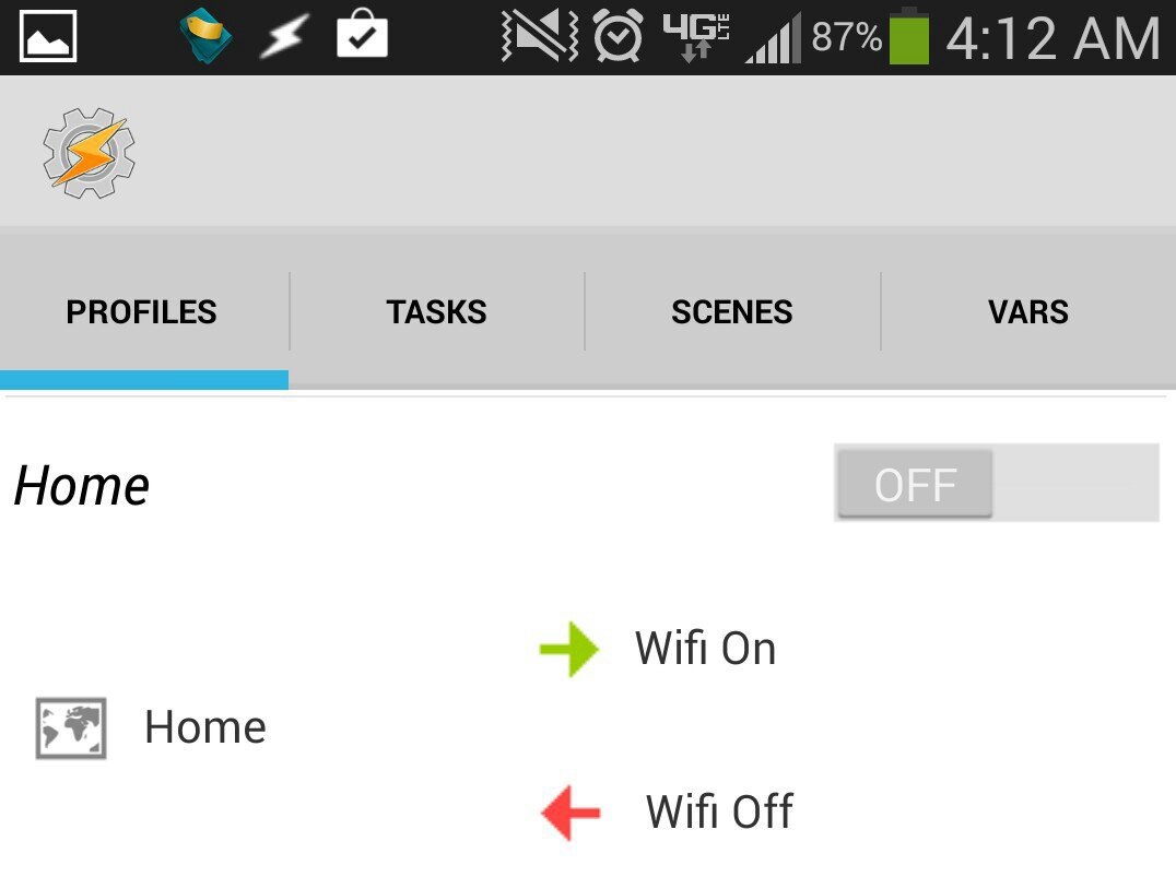

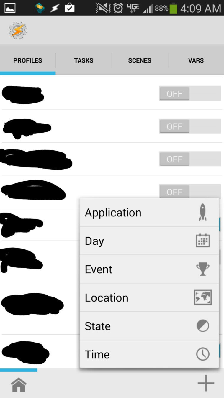

Yes you can set this up using Tasker. Setup home location (or other location) and have Tasker turn off mobile data and turn on wifi. Set the exit task to turn on mobile data and turn off wifi
Sent from my Verizon Samsung Galaxy Note 3 via Tapatalk Pro
Amen to Tasker. Not the easiest to learn to use (ok, one of the toughest), but IMHO, probably one of the most versatile apps available.
