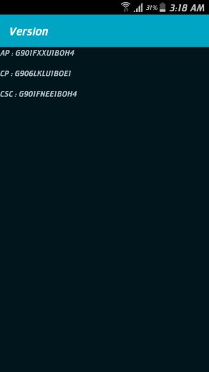

i have S5 prime G906L and its on android LP 5.0.1
Screenshot_2015-11-04-03-18-35.jpg here is the details of the rom ..

Hey there ..
View attachment 204436 here is the details of the rom ..

How very odd!
Your phone appears to be a customised mongrel phone.
AP & CSC = G901F which is the Galaxy S5 PLUS (OH4 Firmware download, here)
CP = G906L which is the Galaxy S5 LTE-A PRIME (OE1 Firmware download, here)
It looks as though you are running the latest Nordic Countries, (NEE), firmware for the Galaxy S5 Plus with a modem for the Galaxy S5 Prime for the Korean carrier branded model for LG Uplus.
My guess is that you actually own the Korean LG Uplus carrier model, G906L, and that you, or someone else, has adapted/rooted and had a G901F mod or custom ROM installed on it recently, (last 2 months).
Since this phone has been adapted/rooted, it will not receive updates and the only stock firmware you can flash to it will be the one for the G906L model for the Korean carrier LG Uplus. This will unroot you.

i bought it 8-9 months ago .. last week ive updated my phone to LP to install NovaRom (custom rom) and now its running this rom ,but i want to go back to KK .. and my phone is Galaxy S5 LTE-A PRIME G906L LG Uplus .. probably because of being Nova rom is made basicly for G901F the AP & CSC in my phone are like this..
so do you thins that i could go back to KK again :-\ ?

You will need to unroot and download and flash the stock G906L, LG Uplus, KK firmware. As far as I am aware, the G906L model does not have a locked bootloader that prevents this unless you have personally altered any .PIT files or the bootloader during your rooting, modding and flashing.
Since yours is a rooted phone issue, you could post any future queries in the Samsung Galaxy S5 Rooting, ROMs & Hacks section of the forum, which is for rooted, modded and hacked phones.
WARNING! By downgrading to KitKat, you will no longer be covered by the last 9 months security updates in the 5 Lollipop releases, for such things as the Stagefright exploit, to name but one.
