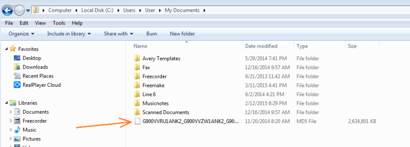

Hello I am new to this site. I just got nailed with the new Lollipop version of Android on my Samsung S5 phone and I absolutely hate it. Im trying to go back to Kitkat version but I am running into road blocks and would appreciate some help.
As of now, I downloaded the firmware from Sammobile/Firmware website.
I also downloaded Winzip. After the firmware has downloaded and I try to extract the files, This is the only file that extracts. What is going on here? Is this the only file I need?
Can someone please help me?
thanks
That is the extracted .tar file that you need to flash via Odin in AP:

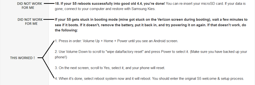

I am happy to report that following the steps listed on the first page got me back into Kitkat mode! :)
I did run into a road block on step 18. See screen shot below.
I must say, I was really intimidated when I first read through these instructions on resetting my phone back to Kitkat mode, but now, after I have finished it,there's not much too it at all. Just follow the steps listed. Thank you for putting this thread together!!! :)
