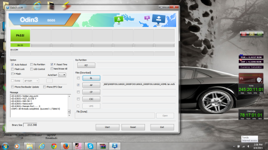

helllo i flash with odin my samsung galaxy s5 i think flash is finished but my galaxy s5 is staying in samsung screen what to do help please

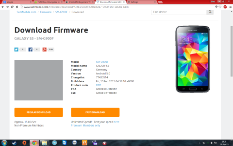

Those are indeed the stock Samsung firmwares for the U.K. unbranded, BTU, G900F.
Try downloading and flashing the latest OC7 firmware...
Model SM-G900F
Model name GALAXY S5
Country United Kingdom
Version Android 5.0
Changelist 4469118
Build date Mon, 16 Mar 2015 06:43:56 +0000
Product code BTU
PDA G900FXXU1BOC7
CSC G900FOXA1BOC7
after first doing a FULL Wipe and Factory Data Reset as described in #2.3 and #2.4 of S5 Lollipop Update Problems - Dummies Guide. After flashing, take the time to check out the phone as per #2.5. Bear in mind that although 2G and 3G should be compatible with AT&T, the 4G/LTE, "may", not be as some U.S. carriers do not conform to the same bands as the international phone models. Try turning 4G/LTE off and just using it on 3G if you have problems. AT&T should be able to advise you of the compatabilty of the G900F on their 4G/LTE network.

If you have a UK phone and its unbranded the the firmware you need is BTU
Full firmware List of currant past and presant are on
Firmware for Samsung SM-G900F - SamMobile
This is the only site i trust
if your unsure on your model its on a sticker behind the Battery
If you put the wrong firmware in eg for another country then the Modem can be a issues as that part of the firmware is wroung
I have seen people that have bought the S5 from a shop in the UK but they were no UK spec phones and failed to work
still as for Rolling back to 4.4 Kies will do this for you and it can also correct CSC codes

I've tried three times to downgrade my wife's AT&T S5. It keeps failing in Odin. Here is the log:
<OSM> Enter CS for MD5..
<OSM> Check MD5.. Do not unplug the cable..
<OSM> Please wait..
<OSM> G900AUCU1ANCE_G900AATT1ANCE_G900AUCU1ANCE_HOME.tar.md5 is valid.
<OSM> Checking MD5 finished Sucessfully..
<OSM> Leave CS..
<ID:0/004> Added!!
<ID:0/004> Odin engine v(ID:3.1005)..
<ID:0/004> File analysis..
<ID:0/004> SetupConnection..
<ID:0/004> Initialzation..
<ID:0/004> Get PIT for mapping..
<ID:0/004> Firmware update start..
<ID:0/004> SingleDownload.
<ID:0/004> aboot.mbn
<ID:0/004> NAND Write Start!!
<ID:0/004> FAIL! (Auth)
<ID:0/004>
<ID:0/004> Complete(Write) operation failed.
<OSM> All threads completed. (succeed 0 / failed 1)
Hopefully someone can tell me what I'm doing wrong here.

I have this exact same problem trying to downgrade from 5.0 to 4.4.2 firmware off of the official site. I have used multiple Odin versions, as well as two AT&T 4.4.2 md5 files. My phone is not rooted, I am trying to downgrade to 4.4.2 so I can root it.
Phone says:
ODIN MODE
Product Name: SM-G900A
CURRENT BINARY: Samsung Official
SYSTEM STATUS: Official
REACTIVATION LOCK(KK): OFF
KNOX WARRANTY VOID: 0x0
QUALCOMM SECUREBOOT: ENABLE(CSB)
RP SWREV: S1, T2, R1, A3, P1
SECURE DOWNLOAD : ENABLE
UDC START
SW REV CHECK FAIL : [aboot]Fused 3 > Binary 1
Odin says the exact same thing as yours.

EXACT SAME PROBLEM as mikaela and mavdoss. And yes Odin is being ran as Admin, on Win8.1 x64. Registered to post this as I hope someone has a solution soon. In the meantime, 5.0 it is...
