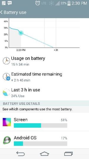

This is what I usually get a day. The battery life on the g³ has been satisfying to me. I think they gave you a crappy phone if you're not getting decent to above average battery life.

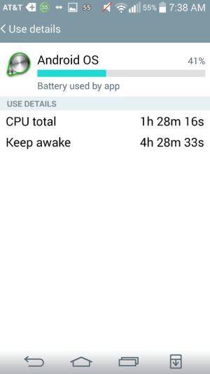

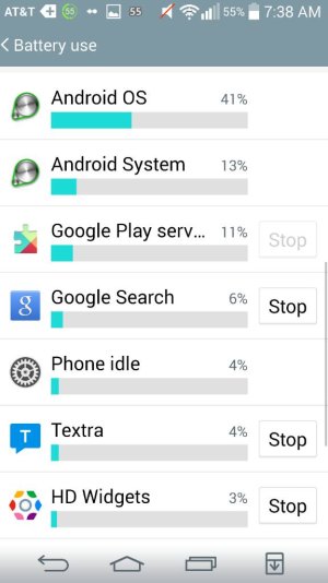

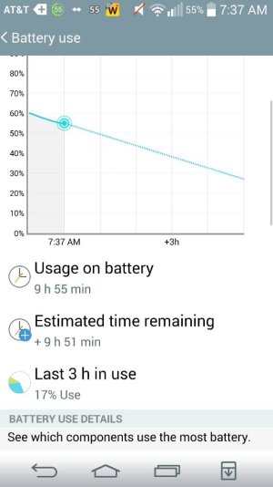

Appreciate all the responses. I will go ahead and take a screenshot and post it after leaving the phone unplugged tonight. That is the part which shows me something is going on. I have turned off auto syncing so maybe that will do it.
Well I left the phone unplugged overnight with auto sync turned off and got very similar results. Battery went from 100 percent to 55. Here are the screenshots.

Any thoughts on why the operating system is using all my battery. What else can I turn off? As I said in my post I have a nexus 7 so I am not completely new to android but this is my first android phone.
