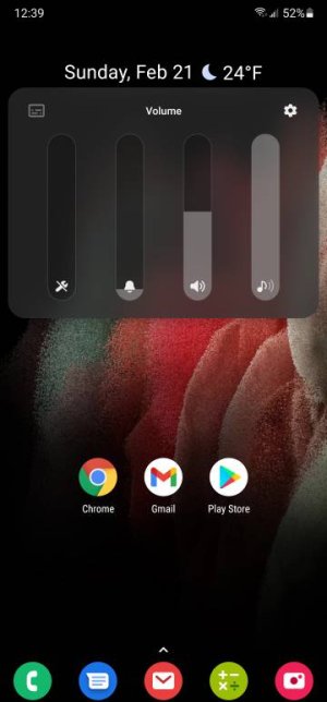

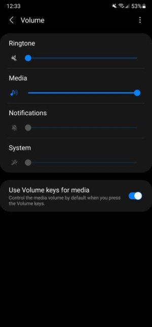

For media, you can set the volume button there instead of volume , but as soon as you touch the volume up or down then tap the 3 dots you can control both volume and media at that momentScreenshot_20210221-003331_Settings.jpgScreenshot_20210221-003904_Nova%20Launcher.jpg
