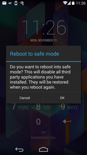

Unfortunately [everything] has stopped.
1. Turn the phone on.
2. Long-press the power button until the menu appears.
3. Long-press the "Power off" option until you see the following image.
4. Press OK to reboot in safe mode.
If the problem no longer exists, then it is caused by a third-party (that is, non-OS) app.
