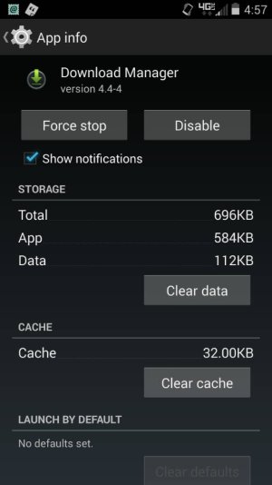

This happened to me today after I switched to ART and then went back to Davlik because I wanted to use Whatsapp, which did not work with Kit-kat. When I tried to reinstall Whatsapp, I kept getting error message 24. I have not seen anybody mention this online and I have been looking all day.
I decided to go to settings, apps, download manager and clear data.
After this, I tried to download Whatsapp once again and it finally worked.
This worked for me. There's a lot messages on this thread, so not sure if you read them all.
