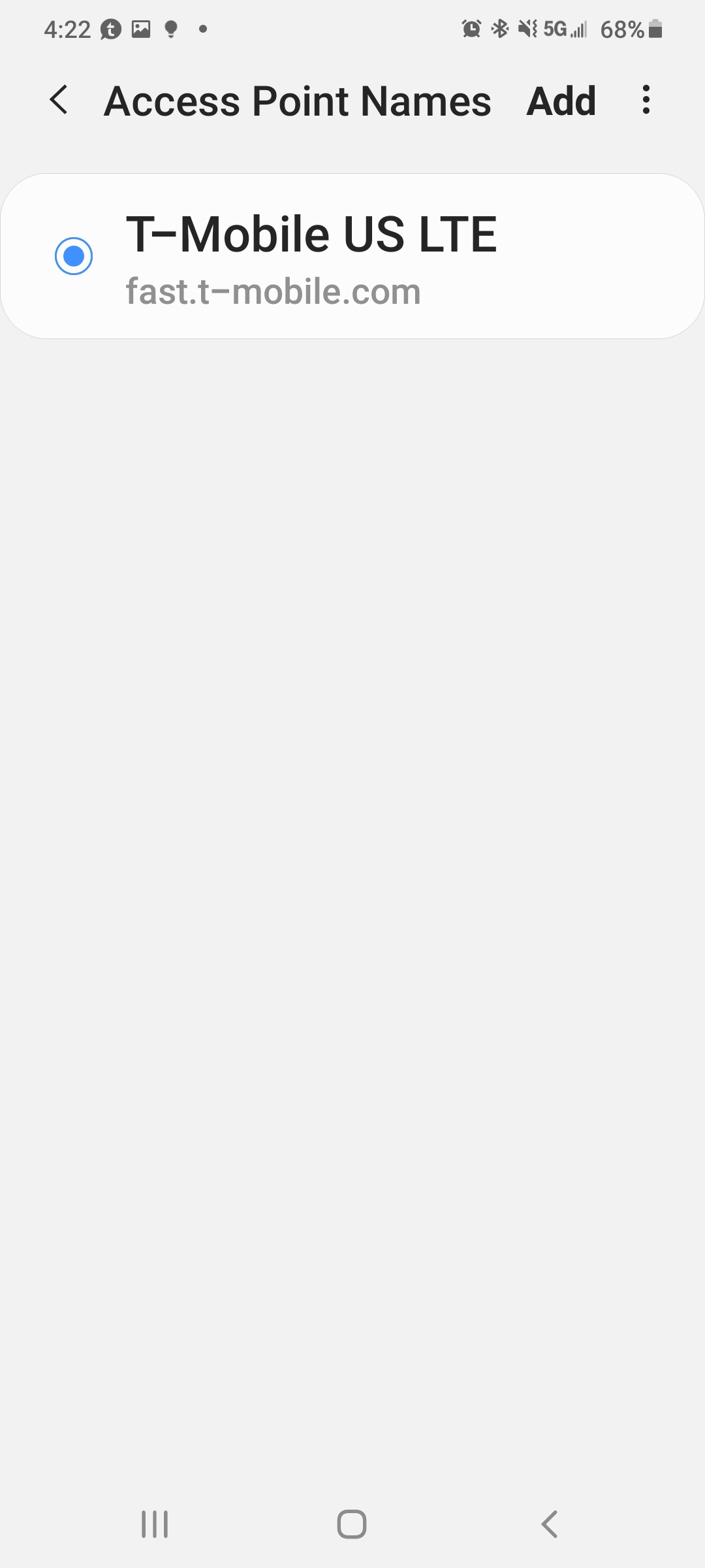

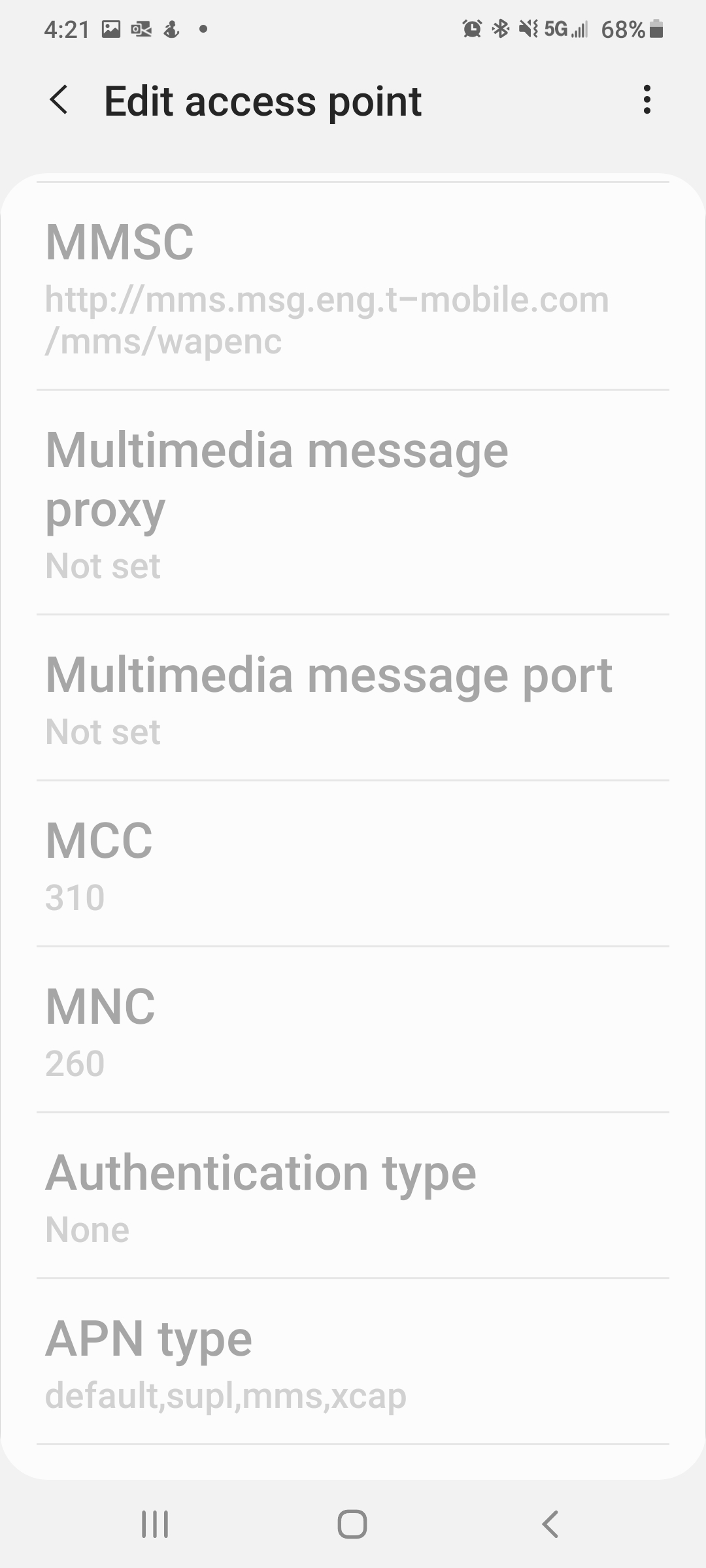

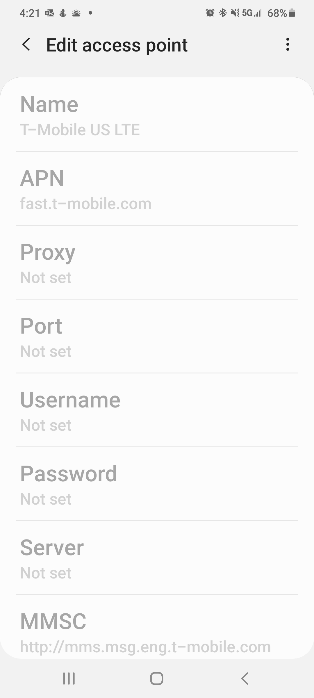

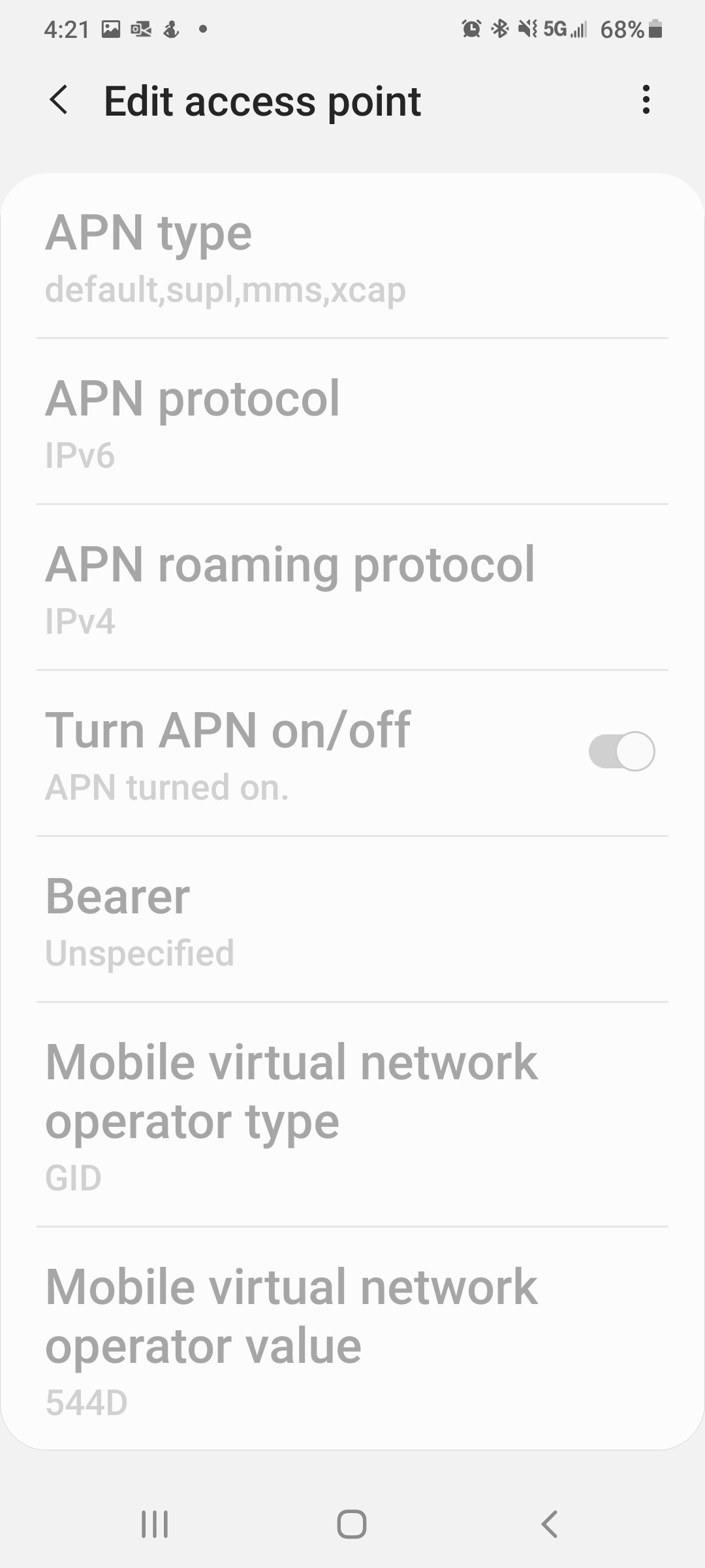

APN Settings on UNLOCKED S20+ with T-Mobile picking up 5G...pls hit Like button if this helps

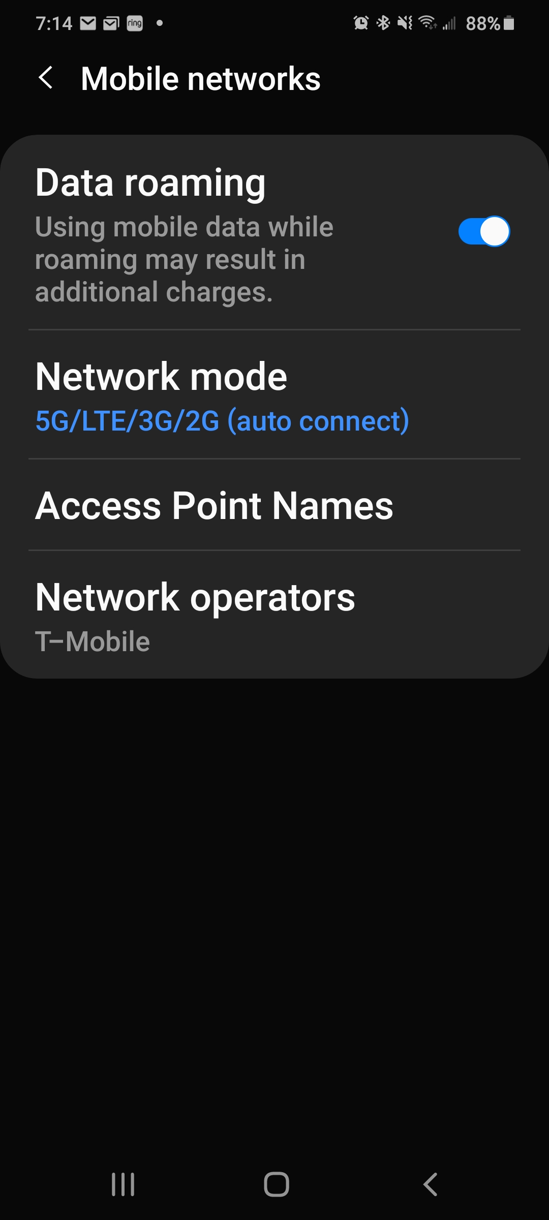

Just making sure but your Roaming is ON and you have confirmed the correct option for 5G is Chosen like the attached screenshot?
Yup. That's actually the problem. I don't have that option for 5G in "Network Mode." I only have the LTE/3G/2G options.
