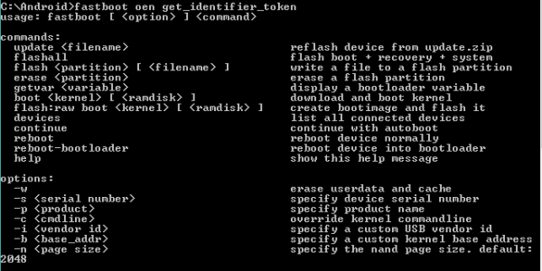

I tried unlocking the bootloader, been am getting stuck. the directions on HTC's site show how to get the token, but when I follow the instructions, instead of getting the token in the command prompt, I get the following:
Could it be that this has already been done (I bought the phone used)?
You have a typo in your cmd, Its best to copy & paste from the HTC instruction page.
yiu havs fastboot oen , it should be oem
No problem we all do it...lol
