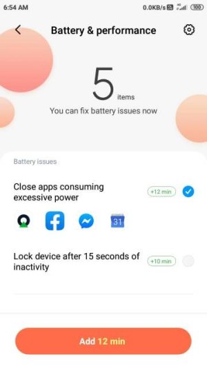

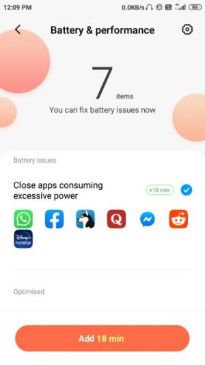

There's inbuilt battery saver pre-installed as component of security app by manufacturer that can be set to keep apps off at background that seems bypassing settings and user permission.

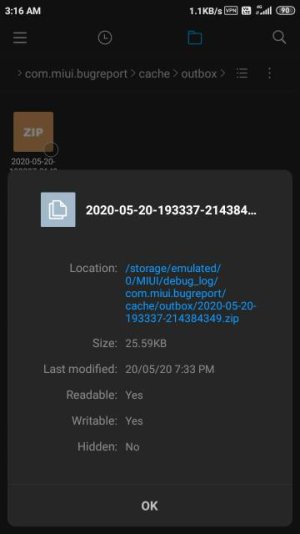

Added to that I've attached details about periodic log generation as well that gets generated automatically even when debug mode of device is set off.
Not much I can suggest for that apart from either (a) rooting the device and trying to disable those system apps (which I wouldn't recommend if you don't have experience with rooting), or (b) avoiding these manufacturers who insist on loading their phones with terrible bloatware that tends to affect performance, and in more extreme cases exposes the user to security risk. You haven't mentioned which phone you have, but since I see MIUI mentioned in one of the screenshots, I'm assuming it's a Xiaomi. The unfortunate truth is that a lot of these Chinese manufacturers love packing in this kind of junk, and it can be hard to get rid of it.
Debug logs are not particularly worrisome. That seems to be a system process, so if it's really important for you to get rid of it, you'd have to gain a lot more experience with rooting and digging into the system. The forums at XDA-Developers.com is generally a better resource for that kind of thing.
