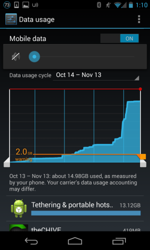

Well crap, i was getting ready to apply 4.4 via OTA to my N4. Now i'm not so sure. I have grandfather unlimited data on my AT&T plan and I use tether a ton (don't have tether on my plan). Usually its for little stuff, but I just had a road trip to and from disney earlier this month. Turned tether on the entire time we were in the car (about 13 hours). between the wife's iphone, kids kindles and ipad, i used almost 15gb (13.12 for tethering) :-)
So, not sure that i'm going to jump on kitkat now... I'm nervous to apply this
DON"T DO IT! I wish to god I hadn't. KitKat isn't worth it. Dammit Google. If it isn't broke don't "fix" it.
