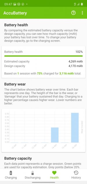

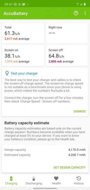

This is what I got back after a couple of charges
