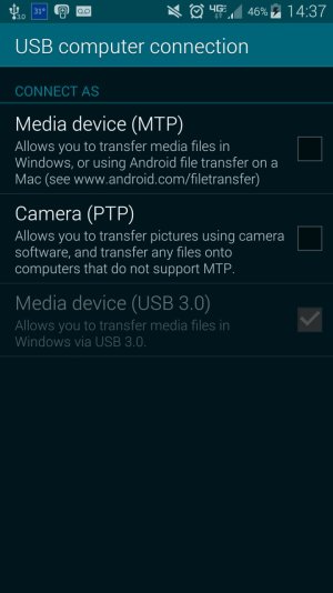

I enabled developer mode on the phone, only different think I enabled in here was debug mode on. then when I connected via the usb that came with the phone I saw the Media Device (USB.30) was checked and the usb notification icon has a 3.0 next to it which indicates it

Don't use the two-pronged USB that came with your GS5. Use a standard micro USB. SD card is fully accessible.
Sometimes SD card is inaccessible after first plugging it in. If I switch to PTP and back to MTP (in the notification area of my phone) I can see my files.
How come my USB 3.0 is greyed out? I need this setting but it will not activate. Im using the OEM cord & all ...?
