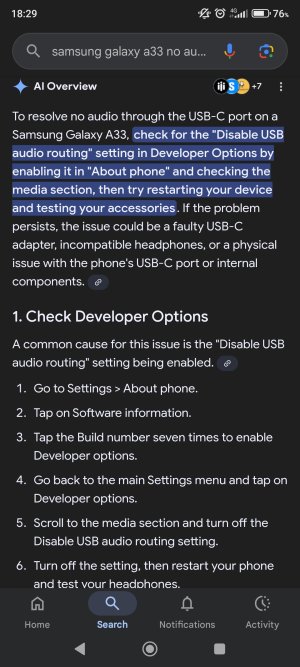

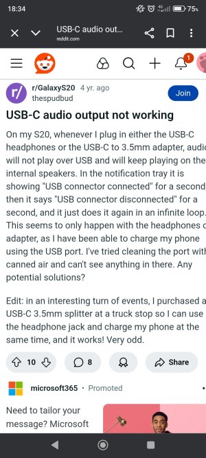

Screenshot_2025-09-18-18-29-18-672_com.google.android.googlequicksearchbox.jpgScreenshot_2025-09-18-18-34-57-820_com.android.chrome.jpg

View attachment 371796View attachment 371797
Thx for the tipps, i tried your suggestion to disable usb audio routing in develeoper options anre rebooted but it didnt work.
