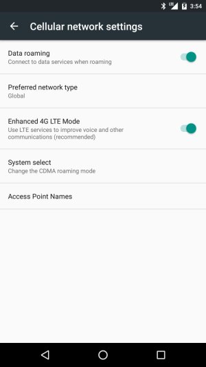

So I've got my 5X. I popped in the SIM from the original MotoX without doing anything else and all seems to be working fine EXCEPT...no data and voice simultaneously? Am I missing something?
Never had a problem on my MotoX but today while I was on the phone I couldn't use GPS so I tested it when I got to the office and yep, no more browsing the internet while on conference calls! Help!
Under Settings -> More -> Cellular Networks I have Enhanced 4G LTE mode turned on. And preferred network type is Global.
and you have Advanced Calling 1.0 turned on with your Verizon Account? Simultaneous Voice/Data work for me.

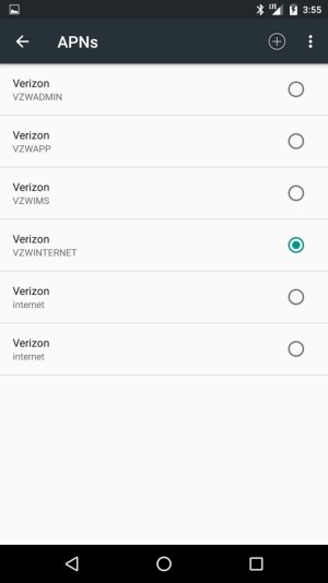

EDIT: here's my settings (sounds like the same as you)
