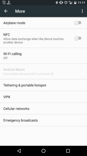

I believe it doesn't show within your options right? When I go to "More" within settings I can see a WiFi calling toggle on my 6P since T-Mobile allows it. I think since Verizon doesn't fully allow it yet (like T-Mobile) it won't work.
Do you see this option?
No wifi option on VZW (5X). Of course, we know the phone and the OS is capable of it. Just not sure how it gets enabled on a device that's not officially supported by VZW.
