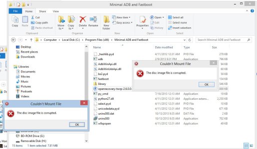

followed the steps until the root. It says my TWRP image file is corrupt...
anybody else getting this?
Re: AT&T One X Root, Boot unlock, S-off on the Jellybean 3.18 OTA Update
both the main and alternative link. windows explorer says its corrupt, and daemon tools is saying "error in command line"
edit: using windows 8
Hmmm. Haven't had anyone have any trouble. Try using mozilla firefox or google chrome. If the problem persists. Check the command you put in the adb/fastboot tool. Also you can try this link.
haha, of course this would happen to me... I'm using chrome and that link^ gave me the same error. Could you elaborate on the command for adb/fastboot? Thanks!
Did you download the adb/fastboot tool from the "flashing a recovery" section?
the only difference i made was save the adb/fastboot tool in "c:/minimaladb" instead of "C: Drive, then to Program Files (x86), then Minimal ADB and Fastboot" as per the instructions, but i dont know why that would change anything
You moved the folder? Please keep it in the Program Files (x86)
