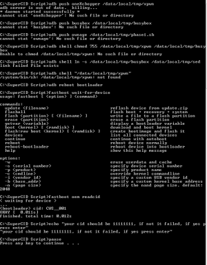

Hey, thanks for the hard work. I think the crux of my problem is I can't get adb to find my phone. I've tried the three methods listed here: the SuperCID Script, the Xfactor, and the Motochopper with varying results.
Here are the screengrabs of what I'm seeing: Photo Album - Imgur
I'm on the AT&T dual core version of the One X. I've checked my drivers and can mount the phone properly in Windows. I just can't seem to come to anything conclusive on this. It seems like adb can't see my phone in certain cases, or perhaps never at all. The USB debugging is enabled.

Hi, please make sure the supercid script and toolkit are in your c: drive. Please do not use xfactor. Also try motochopper again, but this time, send me a screenshot of that as well.

What version of Windows are you using?
Also, can you download android sdk please. There is a link for it in this post in the recovery section. Then follow the steps in the recovery section to change your directory in cmd. Then stop there and type "adb devices" to indeed verify adb is not reading you device properly. Also, do you have HTC sync installed on your computer?
